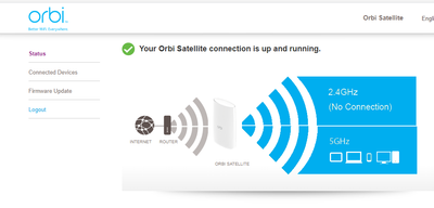

Hello,
I would like to know how to fix when I'm connected to my orbi's WIFI it only shows connected devices and firmware update, I cannot change the SSID or password since there's no setting for it. Can someone guide me?
Thank you

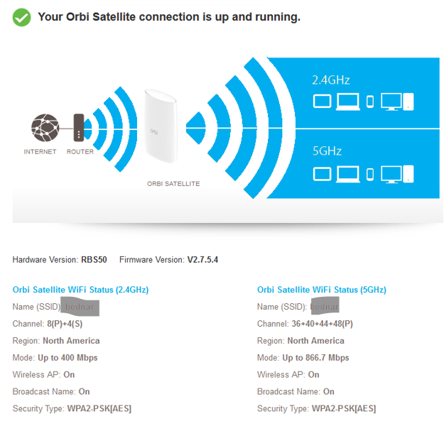

    The SSID is shown farther down the page (see screen shot below).
    There is no method to change the SSID on the satellite itself.  That setting is on the router and the router communicates the proper settings to the satellite.
