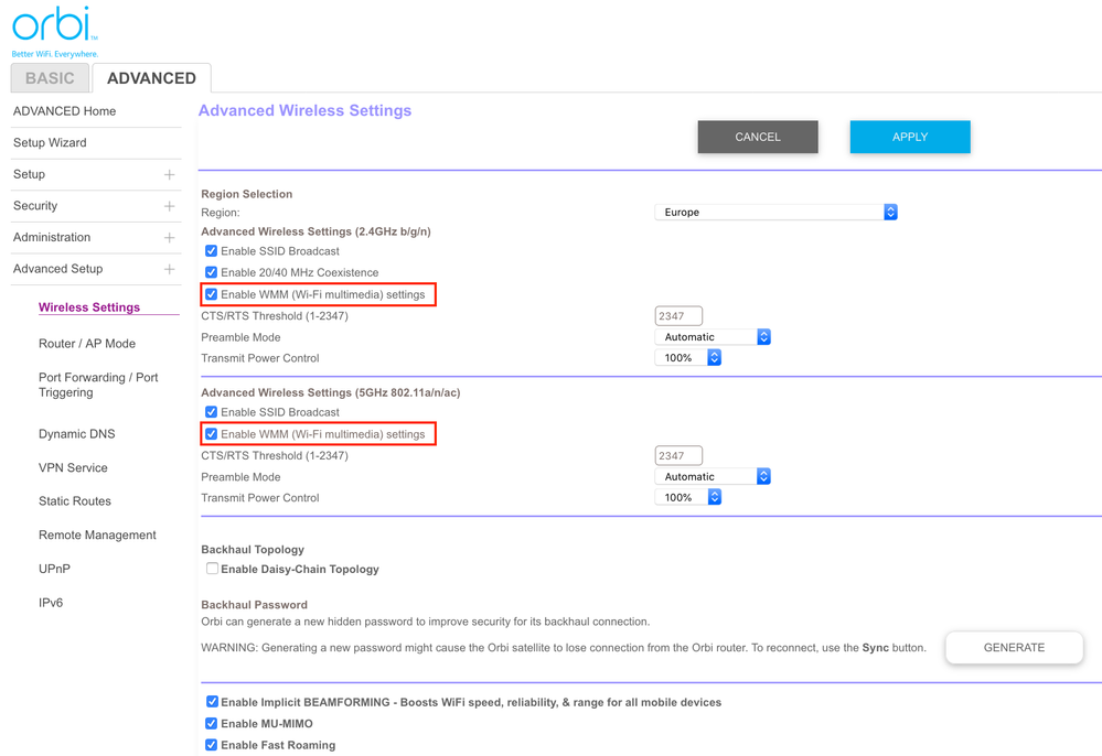

  • Thank you, but the WMM settings are also available in the Advanced Wirless Settings in the "regaular" web GUI here:
    Have yoy tried that?

    Enable WMM is wireless QoS. It should be always enabled for wireless devices and performance with wireless connections. IT should have no impact on wired connections.

    • Did not see that option before, thanks for pointing it out.
      Interestingly despite it being QoS for WiFi only, disabling WMM allowed for all devices (wireless and wired) to obtain the maximum bandwidth I subscribe too.
      Not sure why that would be the issue, but it worked.
      Wifi QoS (WMM) enables wirless devices to give every packet a QoS indicating the type of service. It's then up to the router to prioritise those packets against all other packets in the router: wired as well as wireless.
      So enabling WMM means prioritizing packet for a wireless phone conversation or video streaming over other network traffic of a less critical nature - such as downloadinglarge files (from wired as well as wireless devices) in order not to hear delays in a wireless phone coversation or interruptions in video streaming.
