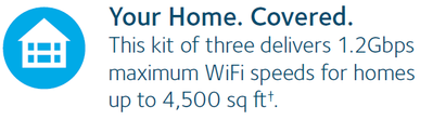

    Can you please copy and paste that comment in the forum?  I believe it is simply a typographical error.
    The Product Data Sheet for the RBK13 package (K for package) https://www.netgear.com/images/datasheet/orbi/RBK13.pdf  states:
    Notice the footnote symbol:
    Which means that 1.2Gbps is a marketing hype created by adding some theoretical maximum speed numbers to get a ridiculous total.  "Full of sound and fury signifying nothing" (Macbeth).
