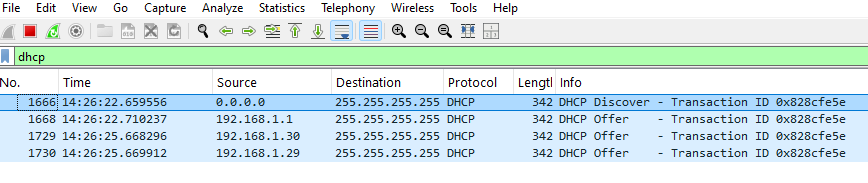

      • CrimpOn's avatar
        CrimpOn
        PFi
        • Turned on DHCP server on a Raspberry Pi on the network Using a DHCP pool of 192.168.1.201 to 192.168.1.251  The Pi  has two network interfaces: 192.168.1.29 (WiFi) and 192.168.1.30 (Ethernet)
        • Started Wireshark to capture every packet going through my PC's Ethernet port.
        • Ran the same command (
          ipconfig /all | find /i "DHCP Server"​and got NOTHING.
        • Then I ran the command ipconfig /renew, and Wireshark recorded this:
           The Orbi (192.168.1.1) and both Raspberry Pi network connections responded with DHCP offers.  Because the Orbi offer was received first, it was the one the PC accepted.
        • So, I am somewhat at a loss to understand the situation. (Like, why does that command work for you and not for me.)  Most of the internet hits I got on searching for DHCP servers are at least 10-12 years old. (There were a bunch of programs written about 2009!)
