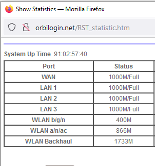

      One tipoff is to open the router web interface (http://orbilogin.net ) and navigate to the Advanced Tab.  Click the blue box "Show Statistics" in the top right box. Here's what my RBR50 looks like:
      If your WAN port reports 100M/Full, then it's time to change the cable for sure.

        I am having the same issue and did what you suggested and my STATISTICS look exactly like yours but when I run speed tests from several different sites I get speeds around 36mbps. When I connect directly into my modem I get the full 800mbps I am paying for. So that tells me it's not the PC's hardware or LAN cable.
