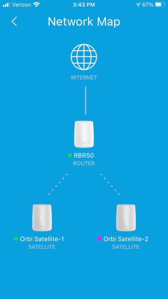

      Thank you all.  I def did the 'Factory Reset' on the satellite.    Pic # one (1) is of the Orbi app showing the available network  [Internet -> RBR50 (w/ green dot) -> Orbi Satellite-1 (w/green dot) & Satellite-2 (w/purple dot).      Pic # two (2) was from orbilogin.com on the 'Attached Devices' screen.  I see this:
      StatusDevice NameIP AddressMAC AddressConnection TypeConnected OrbiBackhaul Status1
      NetgearOrbi Satellite-110.0.0.210.0.0.23C:37:86:2A:3B:CB5GOrbi Router
      08:36:C9:13:77:6C
      Good
      2
      RBS50Orbi Satellite-2--B0:B0:8A:59:FD:93- -Disconnected
      Hopefuly you see this.  If not, it shows Device Name (Orbi Satellite-1 with the IP address, MAC address, Connection Type, Connected Orbi, and Backhaul Status as good.   Satellite-2 onlly shows: the device name, the MAC address, and the Backhaul Status (disconnected).
      I would love to try to IP address update option but I am not sure I have the skills.  The app gives me the IP address but I am unsure how to proceed.
      thank you to all for all your help.
      Jay
