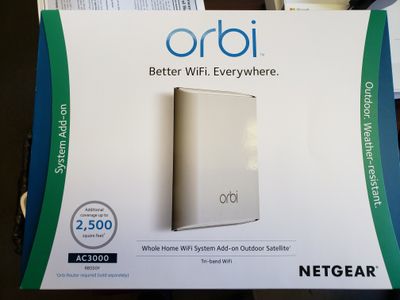

    • I don't remember if I saw that during setup but I knew it did say if you have Orbi products use it as a satellite.  I also remember it said you had to flash the firmware to extender mode if you wanted it as an extender with some other router since it comes with the satellite firmware.  The box even calls it a satellite, not an extender.  I myself was always trying to do the setup as a satellite but it always was listed as a connected device until I reset everything.
