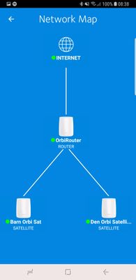

Here is network map...  All green, two satelites, all hard wired backhaul.  Working great.

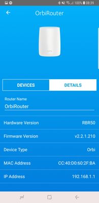

 Here is Orbi Router (RBR50) details screen from Network map.  Current firmware, proper IP address, etc.

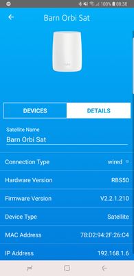

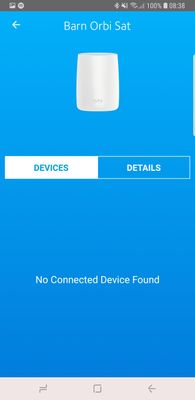

Here is Details Screen from Network Map on one of Satelites  (There are dozens of devices connected to this Satelite)
Here is where you try to list devices from the Network Map.  Nada.  Some people say refreshing on the network map allows it to show devices... not in my case.

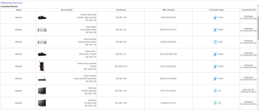

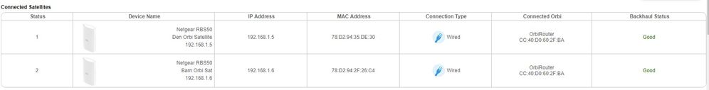

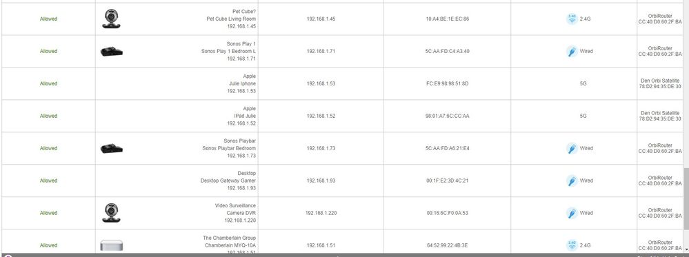

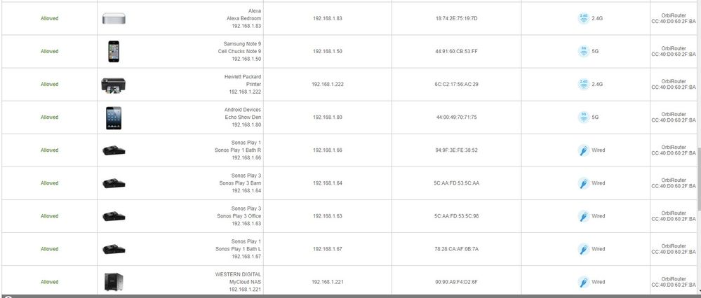

      Short answer:  Web gui shows all devices.  Phone shows none.
      Here are some screen captures that may help
  • The mystery is why it worked with your friend's recent purchase, and not for many many others. My app experience with the network map is slightly different in that my backhaul is wifi. The two solid lines on your example are dashed on mine (dotted actually). Neither the router nor either of the satellites show any connected devices. However, very infrequently the connected devices will show up in partial or total. Perhaps 10% of the time if I wait. Overwhelmingly, nothing shows. The Genie app, which Netgear is going to yank out Orbi support soon, does work. It is curious that your friend's purchase is recent and his app and your app works with the same version of the Orbi firmware at his siteand equipment. It would be worthwhile since your setups are so similar, to check all the settings and topology to see what dissimilarities are there (if any). Somewhere there is a bug, and it soulnds like maybe it is in system settings that is affecting the quality of information getting to the app. Inquiring minds would like to know.
