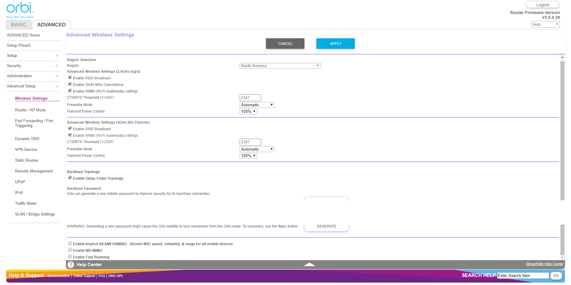

Slow WiFi 2.4 GHz on Orbi
We have an RBR50 with 2 Satellites we Just Started to have slow Speed on the 2.4 GHz WiFi  only, we have had the RBR50 for just over 1 Year and have never had any Speed  issues, we have not moved any of the Satellites we have Firmware Version V2.5.0.38 any help would be appreciated

    Try disabling the following and see:
    Armor, Circle, Daisy Chain, Fast Roaming, IPv6 and Set 20/40Mhz Coexistence to 40Mhz only. Save settings and reboot the router and satellite(s).
      Armor, Circle, Daisy Chain, Fast Roaming, IPv6 and Set 20/40Mhz Coexistence to 40Mhz only. Save settings and reboot the router and satellite(s)Armor, Circle, Daisy Chain, are  disabled
