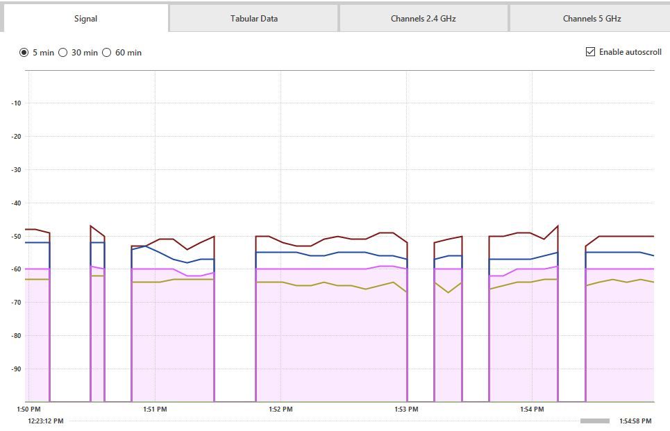

Downloaded Netspot to look at why I was constantly getting drops. I initially thought it was my internet connection but it's my WiFi. I restarted the Orbi (12:33) through the app and everything was great again...
https://i.imgur.com/YfSL8Pw.jpg
Constant bouncing of signal on the router and satellite on both channels again about one hour later.
https://i.imgur.com/Wyo7BlD.jpg
Here's a closeup
https://i.imgur.com/agsZDLE.jpg
What can I try next?
