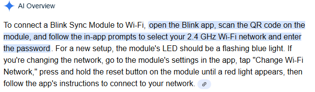

Wifi is not connecting to with Blink Sync Module
Did you ever get this sorted?   I have been searching for answers to this problem and keep getting told to follow this step or that step to reboot and resend but nothing works
