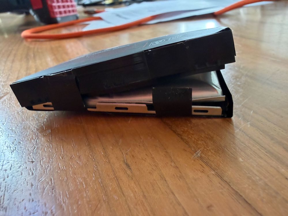

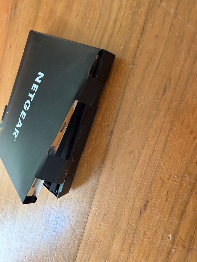

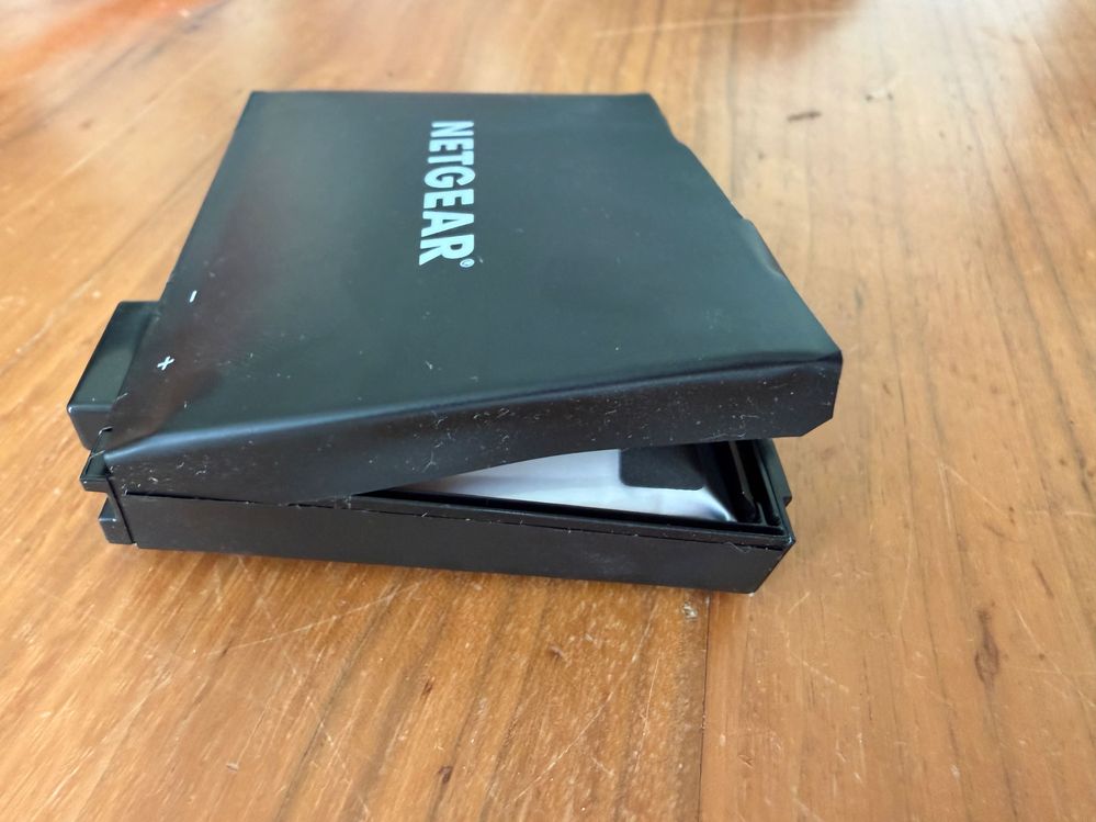

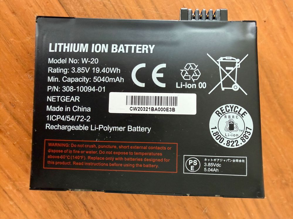

battery nighthawk m6 (mr6150) swelling
hi,
   got a 2.5 year old nighthawk m6 (mr6150) and just notices the battery starts dangerously swelling! this should not happen... it has just been sitting in a cabinet as backup. i bought it at amazon.nl but they do not want to replace it as it is out of warranty. this seems like a dangerous production problem of either the battery or the charging electronics. i do want netgear to know about this.
   also i am a bit afraid to put in a new battery...
   anyone else had this? what should i do?
    Was the aircard on a charger?  Or was it just sitting in the cabinet (not connected to anything)?
    Battery swelling is a common sign of failure in a lithium battery - aging + humidity can cause it.  But so can overcharging.
    boddeke wrote:
    what should i do?
    Obviously dispose of the battery.  Be careful not to puncture it, as that can result in a fire.
    If there is no sign of damage to the electronics inside the aircard, then it should be safe to replace the battery with a new one.  Though I don't think you'll find many Netgear-branded replacements - googling shows mostly third-party replacements when I look.
