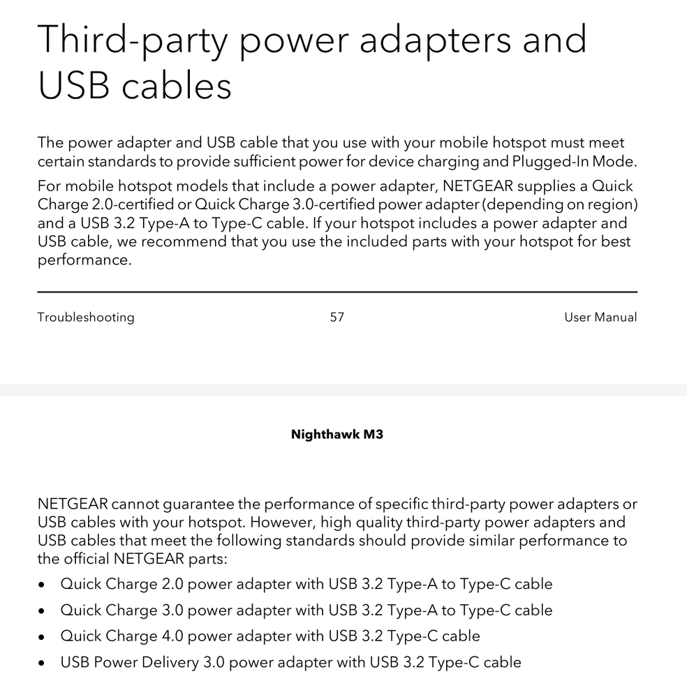

      The router can only be charged via the adapter if a PD-compatible charger is used.
      See the link provied before here to the KB, see the reference with screenshot from the fine user manual. 8-)

    I connected a USB-C charger to the adapter hoping that would solve the issue, but it didn't work. I also noticed that the router doesn't charge at all when connected via the adapter; it only charges when I plug the charging cable directly into the router, bypassing the adapter.
    A random USB-C charger can easily lead to this issue.
    Third-party USB cable and power adapter compatibility with NETGEAR mobile hotspots and mobile routers
    Was already tempted to suggest trying the original Netgear supplied power adapter - to find there is none in the standard delivery 8-(
