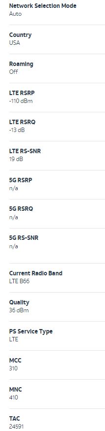

M6 not connecting to 5G
MR6110-1A1NAS. HW Version 1.0  FW Version NTGX65_10.01.22.01
All cellular devices in my household recognize the 5G cellular network. My Nighthawk M6 will not allow the 5G settings for the APN. It acts like there are too many characters. The 5G APN is ATT NR Broadband, it will stop at Broadban. I've tried no spaces, still no luck. I've reset, done a hard reset, removed and reinstalled SIM card. The SIM was previously in an M1 but ATT recognizes the M6 as a 5G device in my devices.
  • I broke down and took everything to a local AT&T store. They confirmed that I had done everything right, the device is a 5G device, and I have 5G service where I live. They also confirmed that this was not the first time they had heard of such an issue. Turned out to be a SIM card issue. They took a new SIM card, provisioned it to a 5G device in the store, installed it into the M6, and now I have 5G service with my hotspot.

      Attached to this is an example of my APN settings.

        I've tried both the app and desktop with no luck. I've also tried every combination of APN I can imagine. I've tried your configuration also with zero connectivity.
