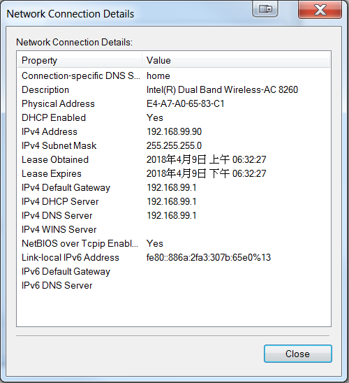

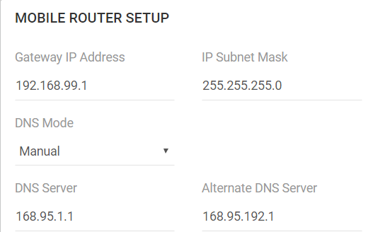

    • W1lliam's avatar
      W1lliam
      Virtuoso
      Here is the snapshot for my client which associated with MR1100, as you can see its DNS is set to the mobile router (192.168.99.1), also attached my settings on MR1100. Seems MR1100 does not reply DHCP request with proper DNS settings on the device.
      William

        Hi W1lliam
        The M1 is acting as a DNS relay to the DNS you set manually. So instead of using the DNS your ISP supplies when you log in to the cell , the M1 should be refering to DNS at  the IP you manually set. As AoC pointed out, the test at dnsleak should confirm where you are actually getting your name resolution from.
