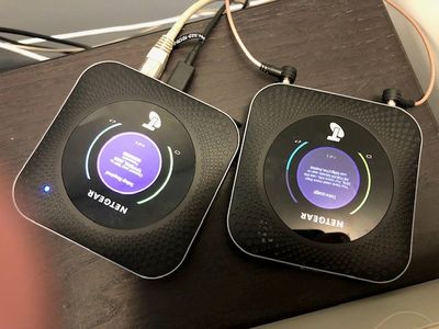

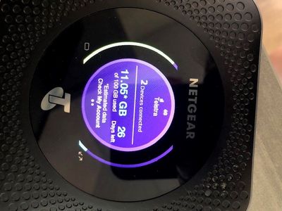

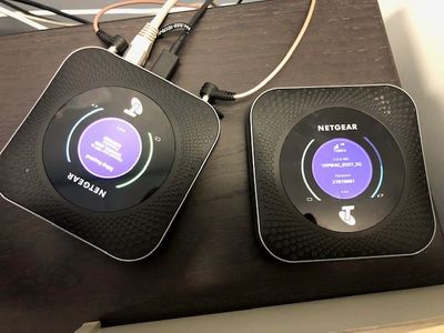

The reason I have posted here is I am wondering whether anyone thinks the images i have attached could be the problem.
1) My Modem - connected to aerial - Blue bar is less than 1/2 strength. Rgardless of how many bars I get (I get 4 at home) the blue bar is always 1/2 strength or lower
The work modem isnt connected to the aerial but the blur bar is full strenght
2) My modem - no aerial. Blue bar is where it normally is. That to me doesnt seem right. Today I am only getting 2 bars as I am at work, at home i get 4. Wheather I am at home or at work the blue bar is always under 1/2. The position it is in in the photo is normal.
3) Work modem - connected to aerial. Full blue bar.
My Modem - Connected to aerialMy Modem - No aerialWork Modem - Connected to Aerial

  • I have had the modem on my desk at work wathcing it, battery only, no ethernet or USB connected. The modem light changes from blue to orange every few hours. The screen shows 0 devices connected, I press the button, the screen refreshes, a few secs later the light changes to blue and shows 1 device connected (my iphone)
    The blue signal strength is stil under 10% even thru I have 3 bars
