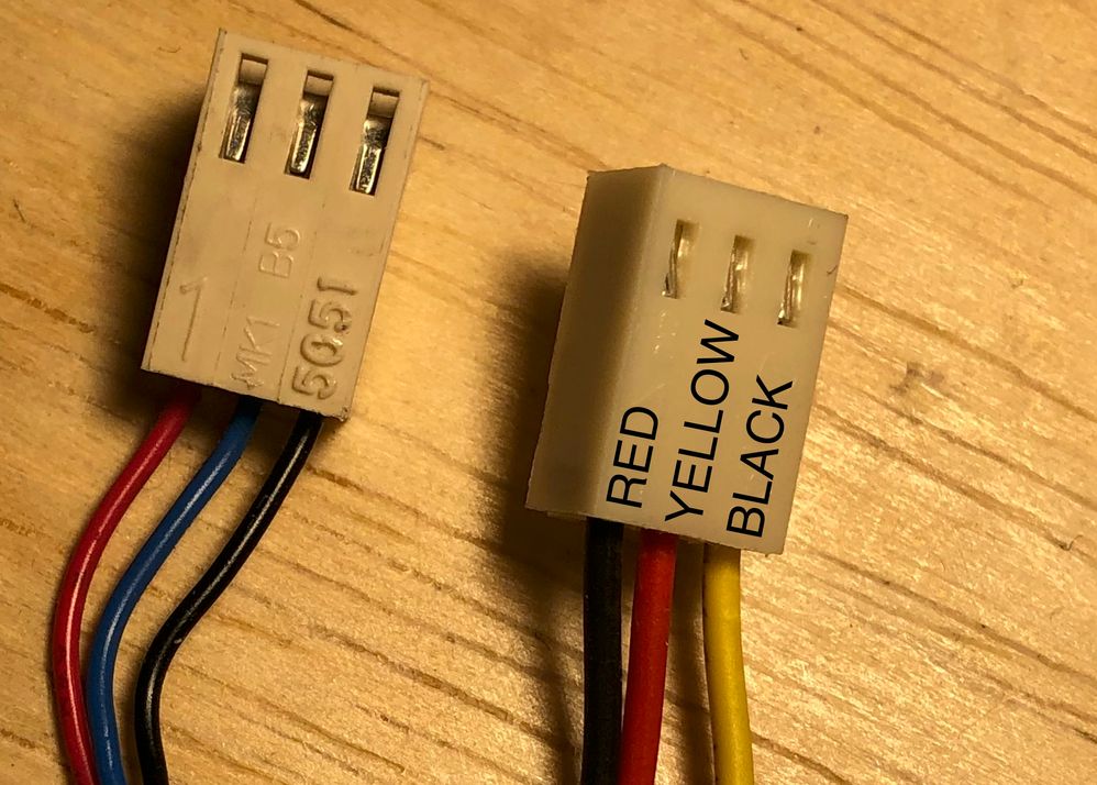

The Netgear stock fans, looking from top, left to right are - Red - Blue - Black
The others i have are - Black - Red - Yellow.

My predicament is that the colour coding on my old ones don't make sense, you'd think it would be standardised. See picture, stock Negear fan on left, new connector on right. My OCD is saying that Red and Black are positive and negative. And the Blue and yellow are the sensor. But the pins all move about!!

I would pop the pins out on the new fan, stick the yellow one in the middle and then with the connector of the new fan facing the same way up as the old one (not as in your last picture) swap the red and black around.
I've tried quite a few now and the cabling on the left is definitely correct for v+, v- and sense.

Would you then agree with the pin config as overlaid on the right plug in the following pic?
- pn23Mar 09, 2021Aspirant
Yes, that's how I've done every one I've tried.
