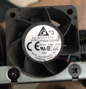

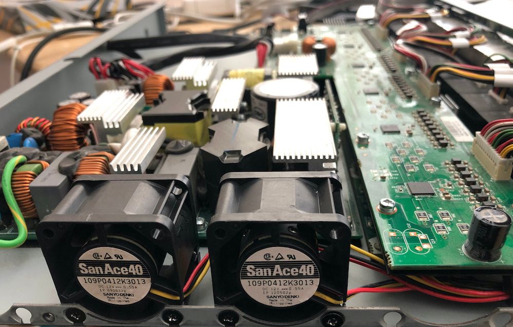

Just received my pair of Noctua NF-A4x20 FLX fans I intended on replacing the stock ones to reduce the noise of the refurbished switch I've just bought, which I waited until I received it to check th...

I would pop the pins out on the new fan, stick the yellow one in the middle and then with the connector of the new fan facing the same way up as the old one (not as in your last picture) swap the red and black around.
I've tried quite a few now and the cabling on the left is definitely correct for v+, v- and sense.

Success. The Pin config has worked.
The two pairs of 20mm deep fans span up briefly and then stopped, like your others. But the deep 28mm work full time. They are noisey!! Having said that, the volume of air they pass is incredible! Nothing is going to get warm inside of here!! I'd almost consider just running one! The noise level is about 55db about half a metre above!
