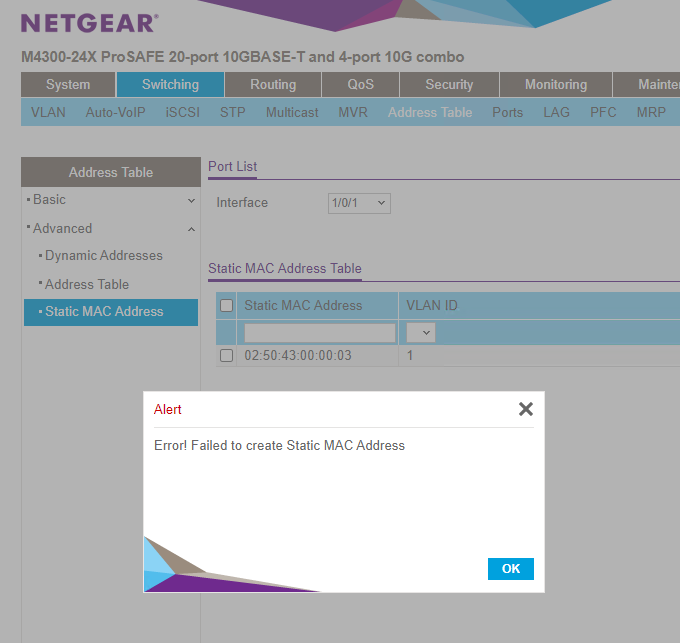

Hi,
I'm trying to enable multicast L2 address routing for specific Mac-Add- 01:50:43:00:00:03 (this is used by a propreitary discovery protocol on my setup). When I attempt to add this address, I get the failure of "Error! Failed to create Static MAC Address". See screenshot below.
I was able to add the address of 02:50:43:00:00:03 (unicast address). It is seen in the screenshot.
I did disable IGMP and MLD snooping- it didn't help.
I didn't find any way to edit the MFDB.
switch FW is  12.0.11.18.
Could you advise?
Thanks a lot!
Elad

      Again I was trying to add this multicast address though switching->address table->advanced->static address table. is this the correct method?
      Elad
