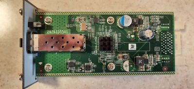

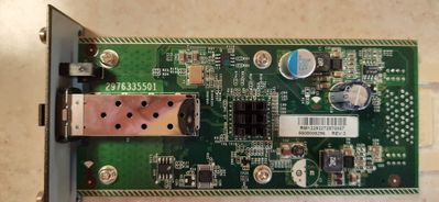

      I bought a new module for testing, and it is detected correctly. Most likely the problem is in the firmware of the old module.
      Here's a new module (s/n 24x17b5600050):
      AX743 new
      Here is an old one and not working properly (s/n 24x1275b0011e):
      AX743 old
      Is it possible to install the correct firmware on the old module?
