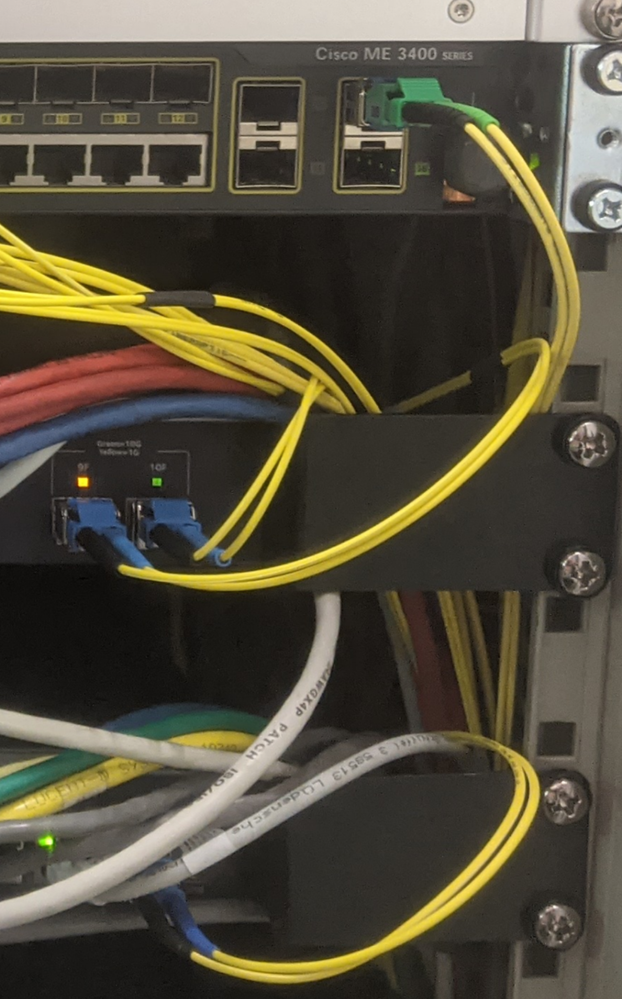

Look here - but don't be confused about the green LC/APC connector on the top Cisco metro switch: There is an additional LC adapter in place with a APC to UPC ferrules!
