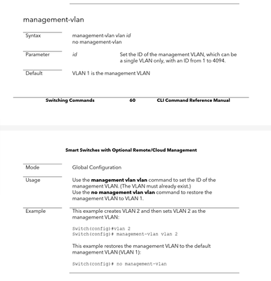

Alternatively, give the Netgear Lite CLI a try, p.60 ff.

Tried and failed with same.. does not stick 🙂 No error message.Sw6# configure Sw6(config)# management-vlan vlan 9 Error! Management access will be lost on MGMT VLAN configuration. Sw6(config)#
