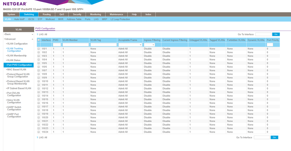

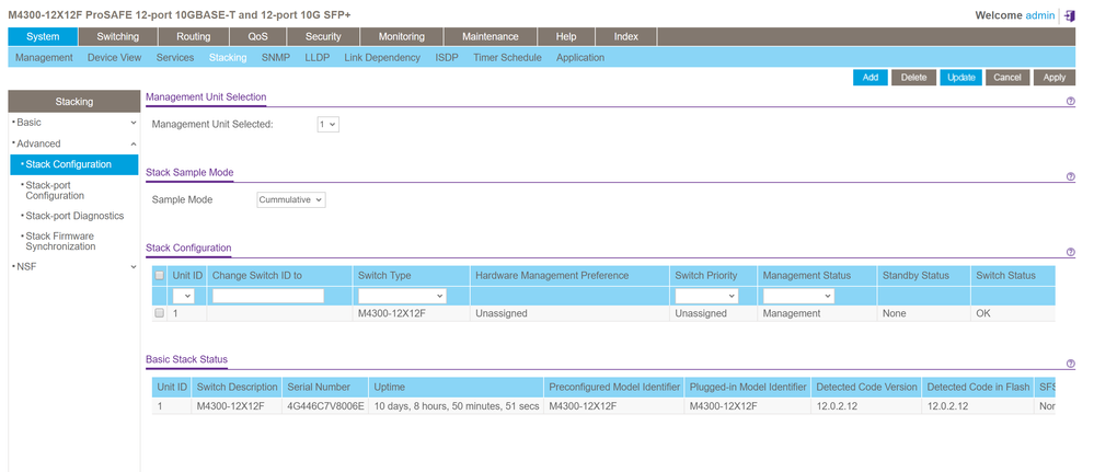

If you can't telnet to Switch, please show info via GUI:
1. Web GUI go to 'System-->Stacking-->Advanced-->Stack-port Configuration'
2. Web GUI go to 'Switching-->VLAN-->Advanced-->Port PVID Configuration'
For further analysis, Could you please provide the config file of the Switch:

- kenjichanhkgJul 19, 2017Aspirant
I couldn't export the Text Config, it just didn't work, nothing downloading.
Here are my screen captures.
