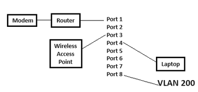

Connected WAP and Router to managed switch with Port 8 assigned to VLAN 200. No internet for WiFi.
I have a GS108Ev3 - 8-Port Gigabit Ethernet Smart Managed Plus Switch that I purchased yesterday. My router is connected to port 1. My WiFi access point is connected to port 3. Prior to configuring the switch to use VLAN200 on port 8, devices using the WiFi had internet access. As soon as I assigned port 8 to use VLAN200, the WiFi connected devices lost internet connection.
If I connect it per this schematic, everything works -- my Roku TV is connected to port 8 and is supposed to use VLAN200. Based on it's IP Address, I can confirm that it actually does get routed into VLAN200 and I'm able to stream youtube on it so I know it has internet access. With this setup, my laptop is able to connect to the internet even when I disconnect the ethernet and use just the WiFi -- when my laptop connects to WiFi, it is part of VLAN100. The list of ports 1-8 represent the Netgear Managed Switch.

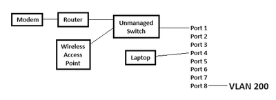

If I connect it per this schematic, the Roku TV still gets assigned an IP address in the VLAN200 range and has internet access. When my laptop is connected to port 4 (ethernet), it has internet access. But no device connected via WiFi has internet access nor can they get an IP address from the router. But since the only difference between those devices working on WiFi vs not working is whether or not the WAP is connected directly to the Netgear switch vs first connecting to the unmanaged switch, I have to believe it's an issue with the netgear switch. The list of ports 1-8 represent the Netgear Managed Switch.

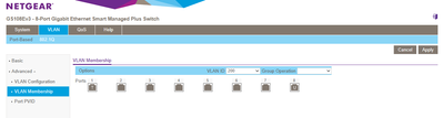

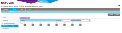

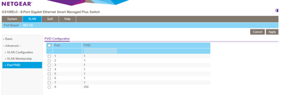

Here are screenshots of my VLAN configurations.

Looks perfect, except of port 8 is assigned as untagged to both VLAN 1 and 200. Based on the PVID on port 8, best guess is to remove it from VLAN 1 - just click on the port in the VLAN 1 definition until the U and T will be removed, then apply.
