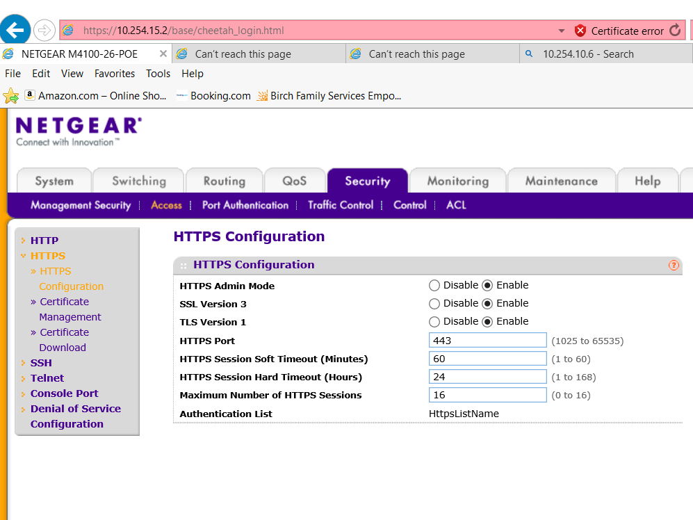

hi there,
after a major power shut down to multiple locations. I just happened to notice I can only access the UI switches only with Internet Explorer. My preference used to be Chrome in Incognito.
Can someone tell me what it behaves like that?
Thank you,

    Hi, I can confirm that the M4100 10.0.2.35 (GSM5212P in my case) is still accessible from Firefox 99.0 and Edge 101.
    It could be that some policy or local settings have disabled TLS 1.0 and/or the ciphers the switch offers in your browsers.
    The M4100 firmware only supports TLS 1.0 and ciphers suites with SHA1 only. At some point browser will start
    enabling TLS 1.0 by default and then it will be become even harder (i.e. disabling HTTPS, back to HTTP).
    The M4100 are end of life by now and the last firmware dates back to late 2019, so while it can still be done,
    the days are counted and you should be looking into a planned replacement for the switches if they are in production
    use.

    • solokifle77's avatar
      solokifle77
      Hi DaneA,
      it actually has the latest firmware 10.0.2.35. I also went to check for the ssl menu and it shows enabled. Do you think it has to do with the certificate expired? I don't know what else to think of at this point because everything was working fine until they have a power outages. It's few of them.
        solokifle77
        Hi DaneA,
        all my browsers are up to date. The switches are connected to USP's, the only browsers that work is IE.
        This is becoming a major concern because we have multiple locations with similar switches model having the same behaviour. Unfortunately, I'm working remotely so I didn't get a chance to connect directly, but later on I can try to connect to a PC remotely on the same lan as the switch and see If I can.
        Maybe it is an ssl certificate error issues. Any thoughts?
