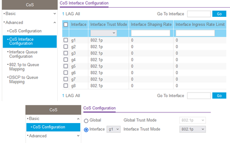

GS108Tv3 - Egress rate limiting option missing
I have a GS108Tv3. The user manual says there should be an option for "egress rate limiting" in the QoS settings but it's missing. The only option I can see is "ingress rate limiting", which is under...

- DragonQNov 11, 2022Aspirant
Thanks, it looks like the wording was changed at some point to "interface shaping rate".
However, the documentation is very unclear. It says both that the "interface shaping rate" field is "the maximum outbound transmission rate bandwidth in kbps" and also that "this setting is used to shape the outbound transmission rate in increments of 1 percent in a range of 0–100." In reality, the field accepts values from 0 to 4096!
If I want to restrict the port to 40 Mb/s egress, what number am I supposed to put in? The link speed is 100 Mb/s, so do I put "40" for 40%?
