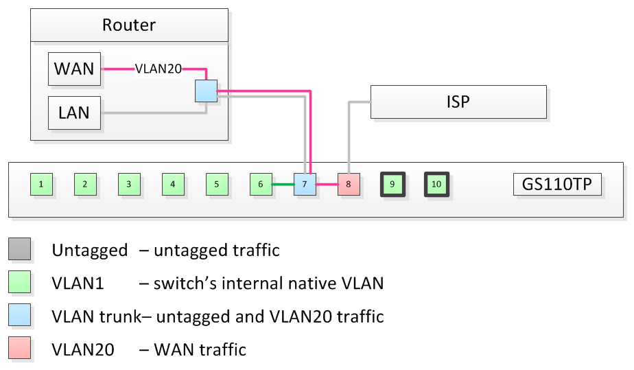

My setup looks like this:
Router has only one ethernet port, so WAN (VLAN 20) and LAN (untagged) traffic is going through the trunk port 7 of the switch.
From there VLAN20 extends to port 8 to communicate with ISP, the rest of the ports are for LAN.

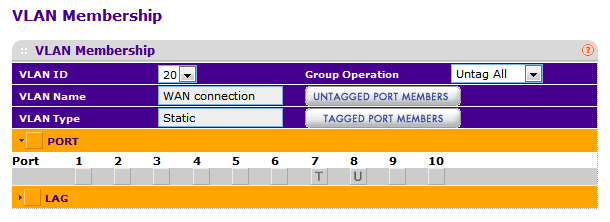

Switch config is:
 Everything works great with this setup.

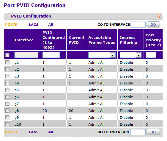

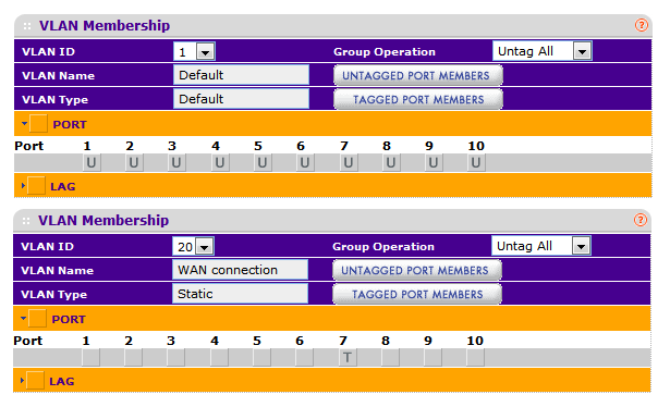

But, once I reboot the switch, VLAN membership gets lost for port 8 (PVID config remains though):
It results in a LAN traffic leak to ISP and WAN traffic is not going out.

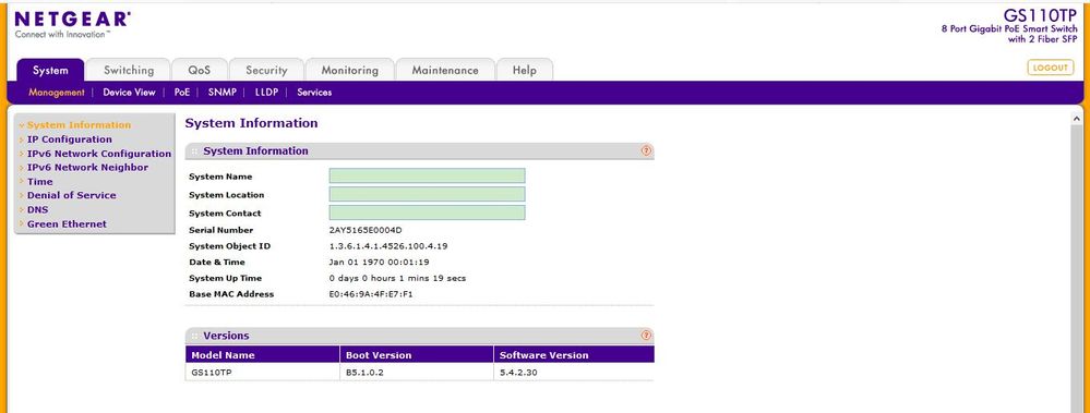

Runnig on th latest 5.4.2.30. Port 8 indeed can function properly untill reboot.

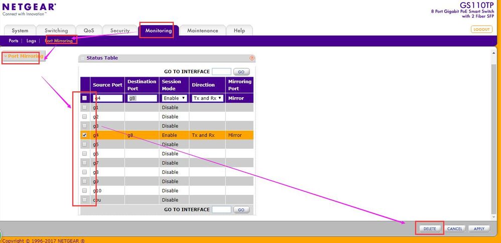

    We found the the reason that make your port 8 lost VLAN configuration.
    The "Probe" status means that port has been set to 'destination of port mirror'.
    In this status, the port will recover VLAN configuration to default after reload just as you
    see.
    Actually port 8 has 'Probe' status will also impact your network forwarding if the purpose is not packets capture.
    So I suggest you to delete port mirror configuration on port 8 just as following screenshot if you don't want to setup packet capture debugging for your GS110TP.
    Then configure VLAN PVID & member on port 8 again that will not lost after reload or power cycle.
    May the solution help you:smileyhappy:

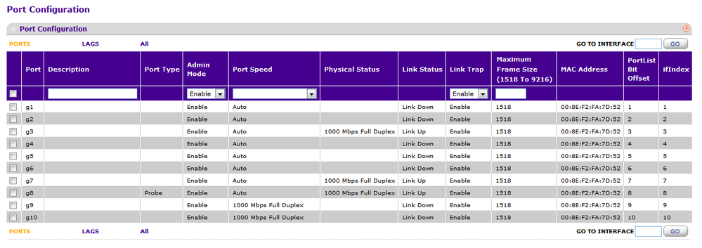

      One thing that might explain the behavior is this:
      The question is what is that Port Type "Probe" on port 8?
        see.
