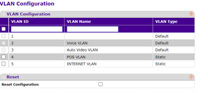

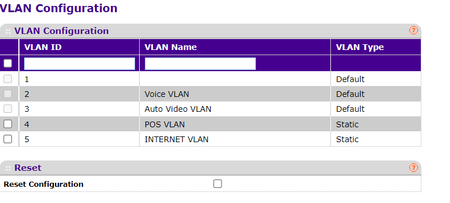

gs516tp vlan help
I could use some help. Im new to setting up VLANS. I have a location were I need to send two separate VLANS over a wireless bridge. Im have 2 new gs308t order but Im trying to learn how to set thi...

Welcome to the Community!
The configuration should be good for both switches. Did you remove the U/T ports on VLAN1? If the laptops can communicate from within the switch it should be good with the trunk port setup for both switches. Have you tried rebooting both switches? or verify the trunk port is working or the cable is good.
