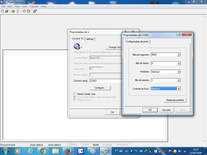

GSM7328S - Briked terminal not working
I'm trying to make recovery of the firmware through the serial port but I can not update. The swich does not respond, does not connect to the network and not the led the doors. the reset button works...

- FelrjnJul 13, 2016Aspirant
I did 30-30-30 procedure and did not work, now the terminal after this attempt shows these strange characters that are in print. And now I can try?
Thank you.- JohnRoJul 15, 2016NETGEAR Employee Retired
Hi Felrjn,
It appears to me that the flash might be broken. I suggest contacting our Support Team, it might be time for replacement.
