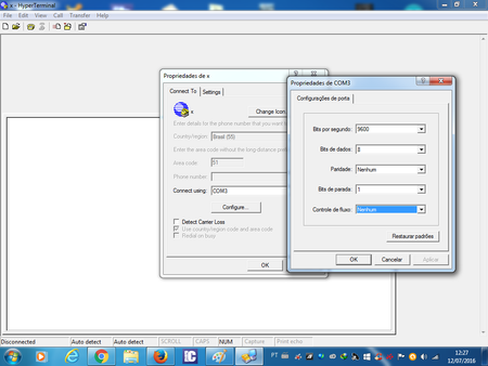

I'm trying to make recovery of the firmware through the serial port but I can not update. The swich does not respond, does not connect to the network and not the led the doors. the reset button works...

I did 30-30-30 procedure and did not work, now the terminal after this attempt shows these strange characters that are in print. And now I can try?
