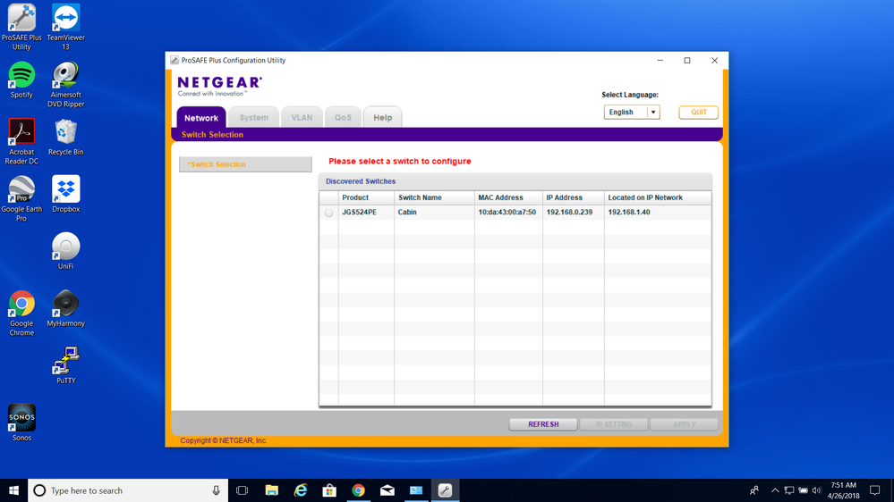

Hi all, I have a JGS524PE ProSafe Switch running Firmware version 2.0.1.26 that have not been updated in a very long time. I wanted to update to the latest version firmware for this switch. ...

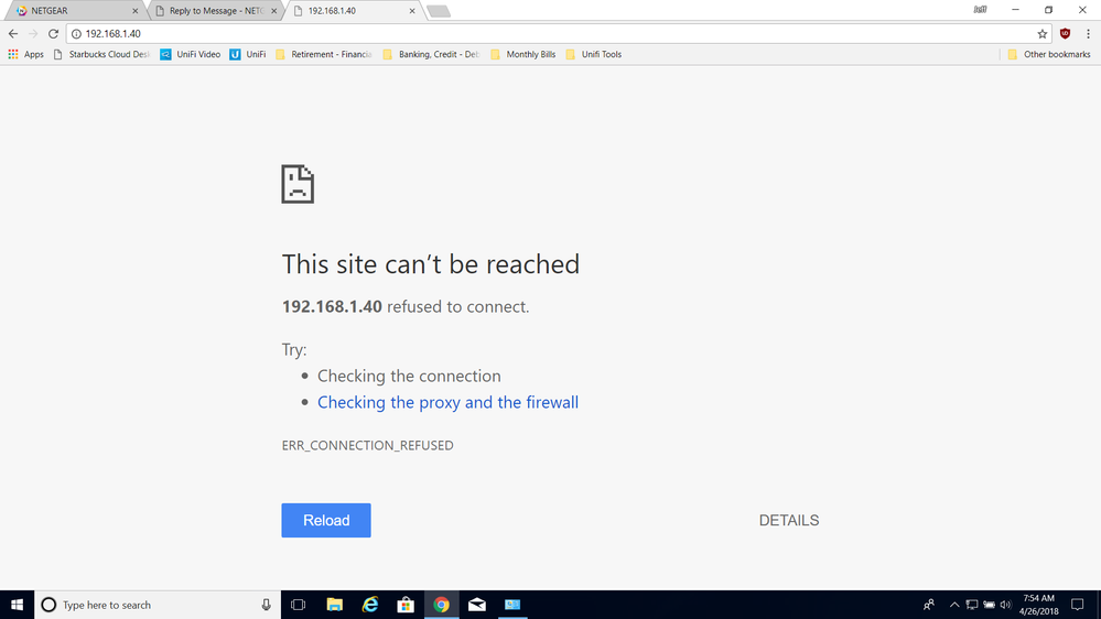

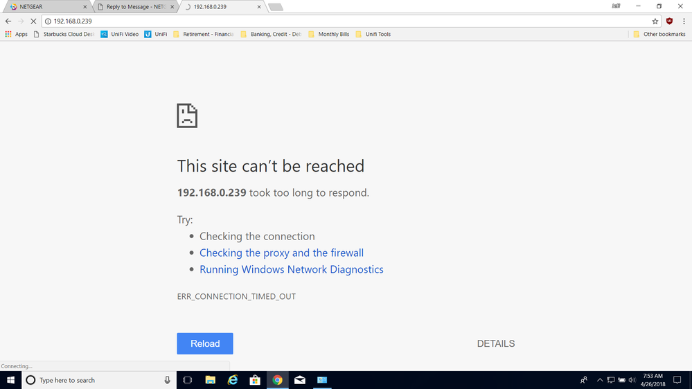

Of course you cant reach it - the first is the switch default IP address, the second is the IP address of your WIndows system. As these are not in the same subnet, the 192.168.0.239/24 can't be reached. temporarily change the LAN IP address of your Windows system to some address in the 192.168.0.0/24 (255.255.255.0) network, like 192.168.0.123. Now you will be able to reach the switch.

What address do I use to get to the switch? Below is what ProSafe Plus shows?
If I currently use 192.168.0.239 or 192.168.1.40 I get the error that the site can't be reached. See print screens.

I finally gained access to the Web UI with all your help and once connected to the Switch the firmware upgrade went fast and flawless. I will document this for myself so I can do it in the the future if the ProSafe Utility is not an option.
