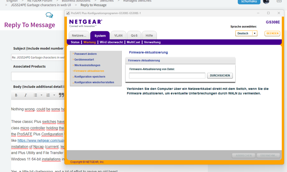

    Nothing wrong, could be some hardware issue, or an incomplete firmware.
    These classic Plus switches have (to my knowldge) no serial port, but are built on an unmanaged core and a tiny 8051-class micro controller holding the very basic Web UI, and the code for the Netgear Switch Discovery Protocol acessible by the ProSAFE Plus Configuration Utility, pure legacy (!), available as v2.7.8 via older model downloads, like https://www.netgear.com/support/product/jgs524pe#download - requiring Windows systems, requiring a workable installation of Npcap (currrent, legacy API), and the switch configured to allow Switch Management Mode, Web browser and Plus Utility and File Transfer via Plus Utility (TFTP) enabled, too. And yes, this does indeed all work on recent Windows 11 64-bit installations in February 2024. Still no switch log, even for old hardcore engineers 8-)
    Said this, 2.6.0.48 is available on the Netgear download page linked above.
    Yes, a little bit challenging, and a lot of effort to revive an old beast. And yes, this is the real utility acutally running as of replying to ths thread 8-)
