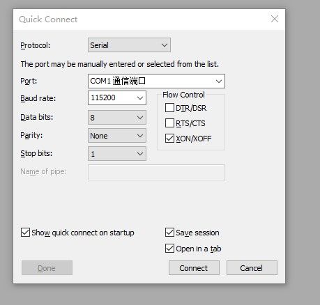

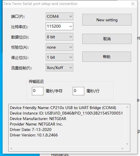

- btmouseAspirant
- btmouseAspirant
- DaneANETGEAR Employee Retired
Thank you for your response. 🙂 If the screenshot means that you already tried it but still the same problem, I advise you to open an online support ticket with NETGEAR Support here at anytime for a hardware check. If ever your M4100-12G-POE+ has been proven faulty, please be ready to submit a soft copy of its Proof of Purchase or Sales Invoice for warranty verification. If the hardware warranty is still valid, an online replacement will be processed.
