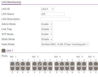

I completely forgot this point ..
There is my configuration. It is still not working with only the 2 fiber ports.
