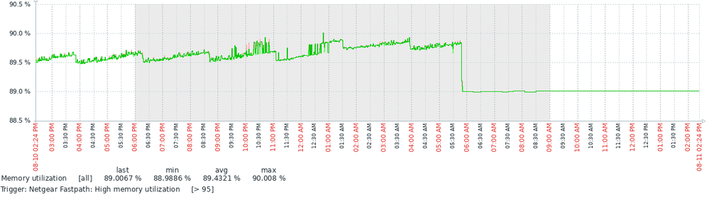

  • We are not using the AV features so supported suggested we disable the AV UI to mitigate the memory leak, it seems to work!
    Their response:
    Good day. I received an update from our higher support team regarding the memory leak issue.
    They advised that if you are not using any of the AV features on the switch, you can mitigate the memory leak issue by disabling the AV UI through the command line(CLI). Since the AV functionality is not required in your environment, disabling the AV UI should prevent the issue from occurring while having no impact on your switch operations.
    Below are the commands to disable the AV UI.
    To Disable:
    (M4300) >enable
    (M4300) #application stop appmgr Application stopped.
    (M4300) #configure
    (M4300) (Config)#no application install appmgr
    (M4300) (Config)#exit
    (M4300) #save
    To Enable: (M4300) >enable
    (M4300) #configure
    (M4300) (Config)#application install appmgr
    (M4300) #application start appmgr Application started.
    (M4300) #save
