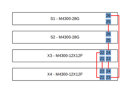

M4300 stacking between M4300-28G and M4300-12X12F
Hello, I want to build stack as in image: All blue ports will be set to stacking mode. I have two questions: 1. Will it work at all? 2. Will I get any speed benefits from additional c...
Can't see anything wrong.
WojtekC wrote:
2. Will I get any speed benefits from additional connections between X3 and X4 ports 21 and 22?
This dobles the bandwidth between the two 12x12f swtches.
- WojtekCFeb 20, 2022Guide
Thank You.
