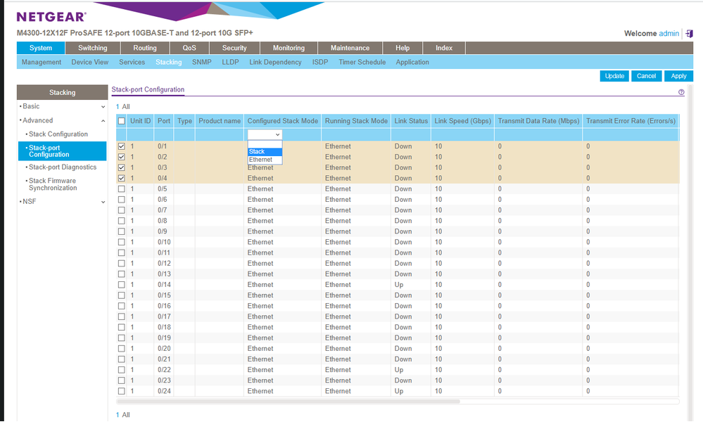

When shipping from the factory, all ports run Ethernet mode. Going to System / Stacking / Advanced / Stack-port configuration, you can select the first four SFP+ ports and configure the "Stack mode" for them. The running mode will still be Ethernet, as a reboot is required for applying the newly configured mode. Don't forget to go to Maintenance / Save Config before rebooting, as you want to save your running-configuration as startup-config in first place.
Prepare both switches this way, and then you will be ready to "connect" them and form the stack. For that, you should power off the switches and physically connect the four DAC cables or the four SFP+ links in between. Power on the first switch, and after 135 seconds (boot time), power on the second switch which will automatically join the stack.
