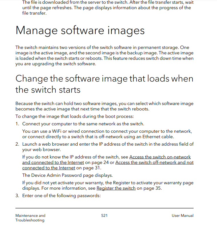

    Common misunderstanding these are not simple consumer switches or appliances - so nothing failed on the update. Much more, all Netgear Managed and Smart Managed Switches are holding two software images in two partitions.
    Here an example from the Smart Managed Switches admin manual section:
