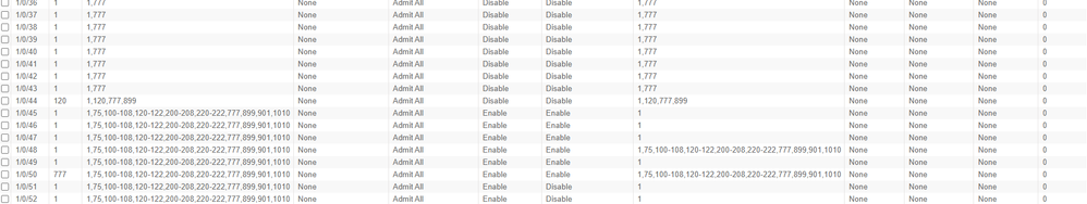

M5300 VLAN IPs 120,777,899
120= 10.120.103.250/22
777= 10.200.77.121/24
899= 10.200.99.120/24 VLAN (back to the rest of the network)

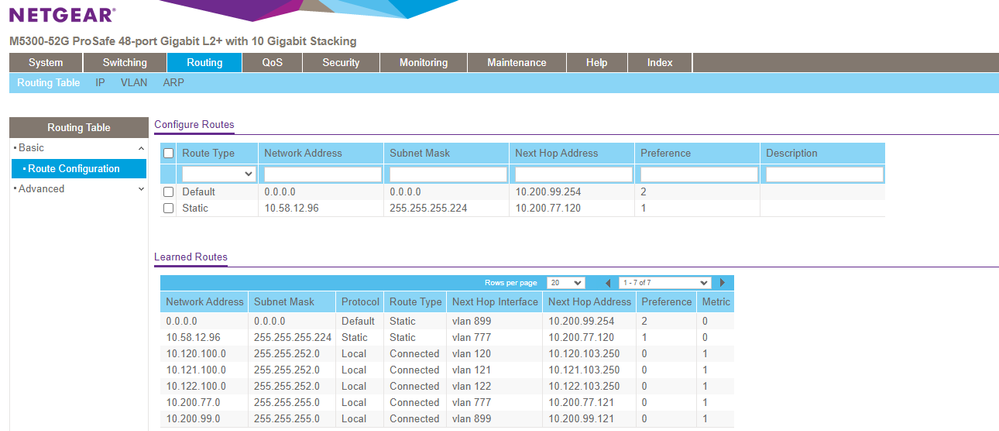

Static Route 10.58.12.96/27 next hop 10.200.77.120

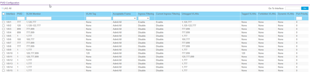

Port 1 PVID 777 (Members1,777,120) out to VPN device 10.200.77.120
Port 2 PVID 120 (Members 1,120,777) My PC
Port 49 PVID 1 (1-4093) Trunk Port back to Core Switch
So hook up VPN device to Port 1 and my laptop to Port 2. Give myself a static IP 10.120.100.50/22.with 10.120.103.250 as my gateway Cool works fine, I can access the VPN Device with 0 trouble
Hook up my trunk port and connect back to the rest of the network, and that static path no longer works, even with my PC still having the M5300 10.120.103.250 as my gateway.

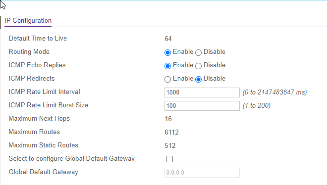

And routing Mode is Enabled.
