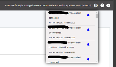

I can reach everything and ping everything.
I have setup Class B scopes but I am unable to obtain IP addresses from my DHCP server.

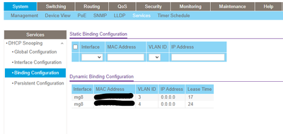

I found DHCP Snooping and I can see the requests going through in the correct VLANs, but I am afraid that without helper address they don't reach.

I also checked the bindings, and the DHCP server is correctly bound to its IP.

    For contest - this is what I see on the switch and on the AP.
