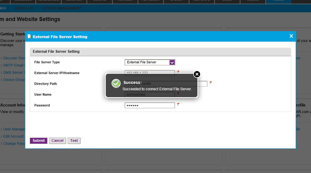

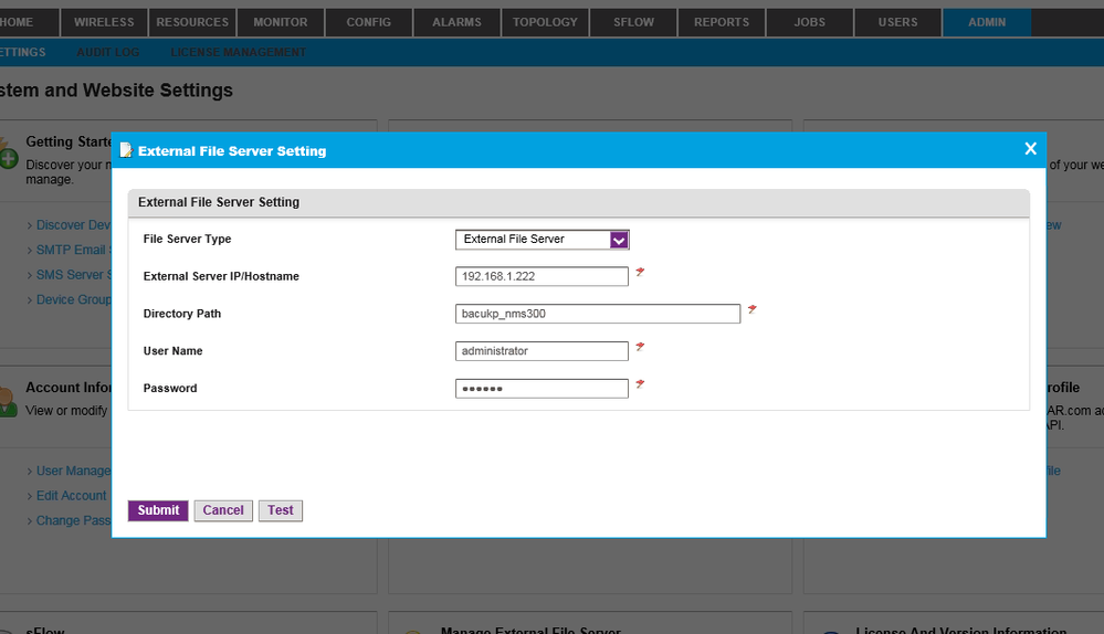

I tried it and it worked on NMS30 1.6.0.22.Please refer to my steps.
My configuration steps are as follows:
1. Created a folder in D disk root directory
2. Share the folder and select some user can "Read/Write". (For example "administrator")
3. Set configuration in the External File Server Setting (Please see attachment file)
4. Click "test" for test whether the folder can be accessed on NMS300(Please see attachment file).
PS:Suggest closing the firewall on the PC.
