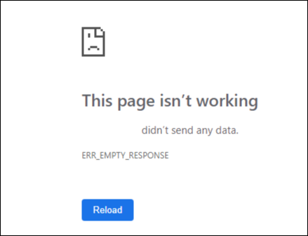

      Thanks for the reply.  I'm needing to connect from a remote computer and have tried what you posted below.  But sadly it does not connect and displays the following...

        All sorted now.  The issue was the firewall on the Virtual Machine.  Allowed the NMS software through and it works fine now.  A simple mistake.
