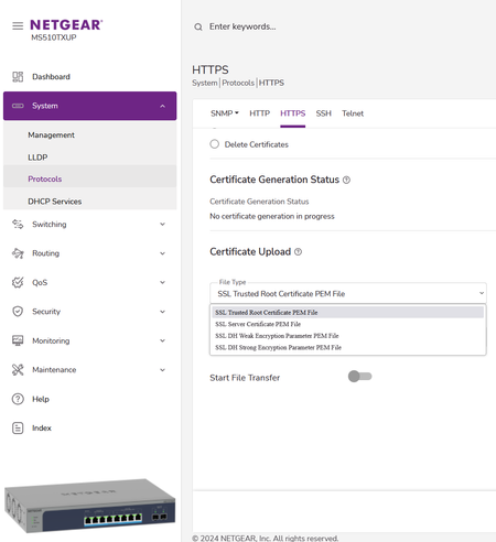

The MS510TXUP Smart Switch has some confusing typos on the page used to upload HTTPS certificates whilst on the latest firmware version 1.1.0.9 (and all versions before it). The user is presented with the following options: "SSL Trusted Root Certificate PEM File" should be used for the X.509 Public Certificate PEM File, and "SSL Server Certificate PEM File" should be used for the X.509 Certificate Private Key PEM File. As my device is out of warranty, I could not find any way to make Netgear aware of this issue. If anyone from Netgear sees this, please the typo be resolved? Also, TFTP is insecure and should not be used to transfer private key files. Please could a secure alternative be implemented?660Views0likes2CommentsM4300-96X REST API - Issue Querying Ports 65-96
