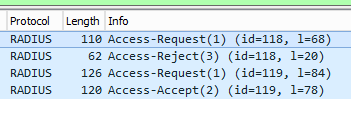

When I log in via SSH, the request is sent twice:
- I connect to the switch via SSH.
- I type in my username, and hit return; an "Access-Request" messae is sent the server (for some reason), but because I have not typed in my password yet, it also sends the "User-Password" field as blank. This fails against my network policy in NPS and generates a login error.
- I then type in my password: a second "Access-Request" is sent to the server, but because both my username AND password are present, I receive an "Access-Accept" back.

    • Just to update: I tested this on a switch upgraded to 12.0.4.8 and I'm still seeing duplicate requests.
