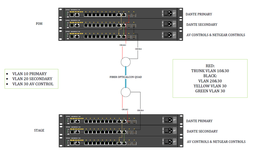

Hey all,
We want to create redundant lines for our Audio and in de future video over IP.
The idea is to run a Optical con quad fiber with 4 LC's from foh to stage to connect all audio and controls.
Could anyone please tell me if I am doing this right?
3 m4250 switches at front
3 m4250 switches at the stage
Switch 1 primary dante
Switch 2 secondary dante
Switch 3 AV controls and netgear controls
VLAN 10 primary
VLAN 20 Secondary
VLAN 30 Controls
The fiber cables are connected to sfp switch 1 and SFP switch2
for switch 1 it will be a trunk Vlan 10 and 30
for switch 2 it will be a trunk Vlan 20 and 30
Now here is the question:
if I run a cable from switch1 port 10(vlan30) to switch 3 and also a cable from switch 2 port 10(vlan 30) to switch 3
can I manage to get this working over the fiber cables and also be redundant.
If switch 2 breaksdown we are still up and running and switch 2 same idea.
Love to hear from you gus thanks in advance. #m4250 #redundancy
Mitch
