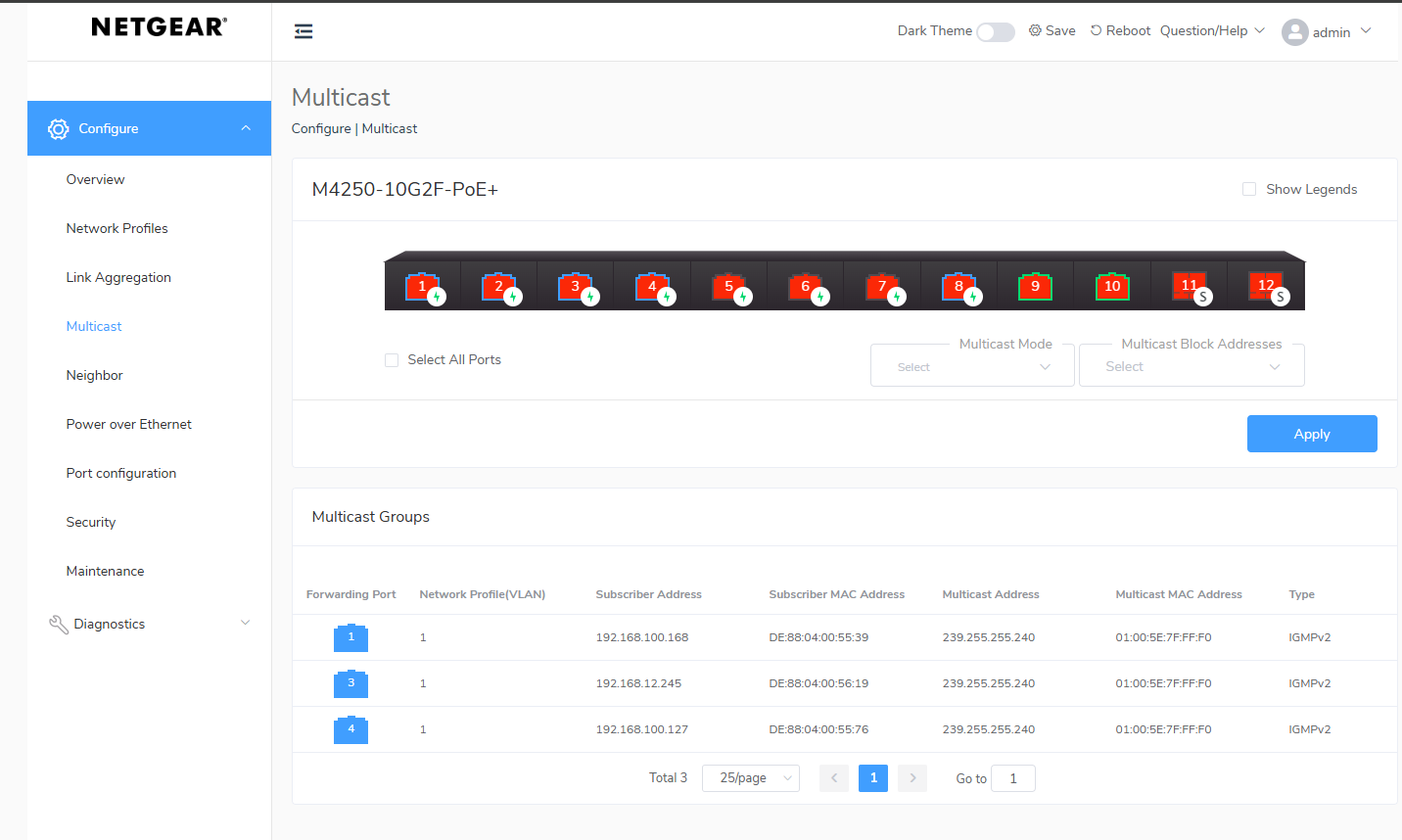

M4250 driver update issue
After support got my switch running. the switch has worked just fine. I updated it because I was going to trunk a new switch. After the update. I now have 2 cams showing on 192.168.12 and 2 showing up on 192.168.100. .12 is my address from modem/router so when I go to OBS or NDI Tools, all I get is the 2 cams on .12

Finally figured it out.
For some reason the 2 cams had reverted back to static ip addresses.
Not sure where the .100. came from as the cams factory setting was a .1. address
Whatever, its back to working
