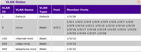

Good morning/afternoon/evening (up to you really), First of all, i just want to lay out that my knowledge on Switching and VLANs are rather limited, im a student in electrical engineering in tele...

As I understand, the Zhone MXK-194 is connected to port 10 of the FSM7328S switch. Is the Zhone MXK-194 a VLAN-aware device? If yes, port 10 should be set as tagged (T) port. Tagging a port is same as setting a port as trunk. Then, you can set the PVID = 1 on port 10. Make sure that the port on the Zhone MXK-194 where port 10 of the FSM7328S switch is directly connected to is set as a tagged port (trunk) as well.

Yes, the MXK-194 is a VLAN-aware device, as far as my understanding goes. In the current configuration, port 10 is tagged for the 3 VLANs associated to the services (100, 200, 300), but physically port 10 is empty and the 3 services are sent to the MXK-194 trough ports 8, 11 and 12 ; which are marked as untagged for VLAN 3 (VLAN for a Linux server). My teacher told me that it works, although he is not sure how. It was set that way by the previous student that attempted this after he could not assign VLANs 100, 200 and 300 to port 10. Is it even possible to assign multiple VLANs to a single port on the switch??

In setting up 802.1Q VLAN, it is possible that a single port can be a member of multiple VLANs.
