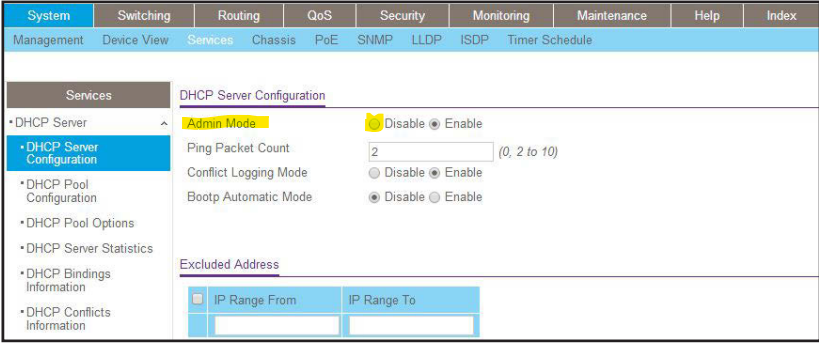

From the IT Web interface, disable resp enable the DHCP server service as required.

- schumakuFeb 04, 2024Guru - Experienced User
System > Services > DHCP Server > DHCP Server Configuration.
Somehing like this:
AV Line of Fully Managed Switches M4250 Series Software Administration Manual Firmware Version 13.0.0 - Chapter 21, DHCP Server
- UMJonnyFeb 04, 2024Aspirant
Ah, so you're suggesting that i just enable and disable one of the DHCP servers as needed. Not an option, unless i can do that via SNMP.
This is somehting that needs to happen automatically without an admin or programmer around.
