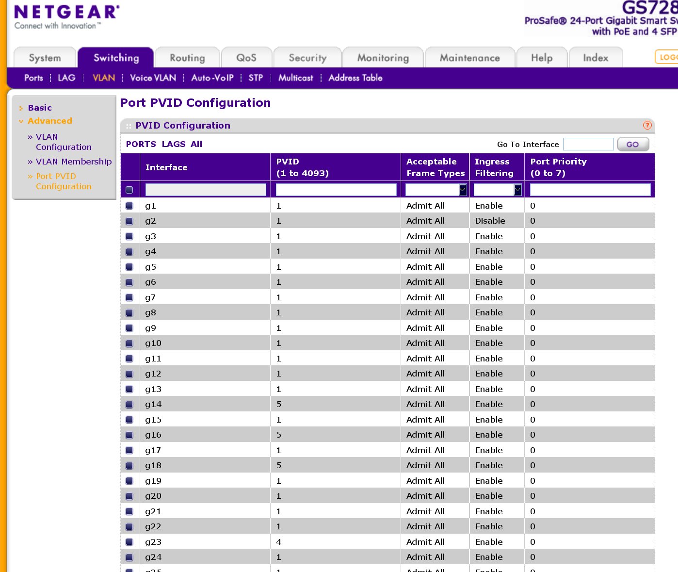

VLan not VLanning on GS728TP
Have several cameras which I'd like to put on their own vlan. And I have a server that handles those camers, which I'd like on the camera vlan and default vlan. I find that the GS728TP has 3 default v...

Quantumn
Oct 17, 2017Aspirant
Sure. Port 3 is the cameras server, and ports 14, 16, 18, and 20 are cameras.
Cameras are HikVision DS-2CD2632F-IS and Samsung (Hanwha) PNO-9080R.
This is vlan1.
Quantumn
vlan4
- QuantumnOct 17, 2017Aspirant
vlan5.
And vpids.

 - QuantumnOct 18, 2017Aspirant
I can indeed now ping the cameras from the cameras server.
But this doesn't make sense. I see why the pvids must be this way, but this is adding the cameras to both vlan4 -and- vlan5? This way I am depending exclusively on ingress filtering to separate the vlans? Nowhere does any documentation describe this method.
Is this the trick so that the cameras server (3) can dwell on both 4 & 5 and so the cameras can communicate with it? But the cameras server has ingress filtering set to 4, so how can it receive anything from 5? Why must the cameras be in both vlan 4 & 5 when 5 is their domain?
Port 23 is the LAN printer, so this should only be on vlan4 and pvid4?
And what about admin of the switch? Port 2 is what I admin through, so should it be on vlans4 and 1with vpid1? Or vpid4?
My understanding is that only one Default vlan is allowed for each vlan? So from a security standpoint (such as it is for vlanning), shouldn't only the admin machine have access to the switch Default vlan? What is the purpose of the A/V and Voice Default vlans?

 - QuantumnOct 19, 2017Aspirant
I am now beginning to understand this, thank you.
But with port 2 on vlan4, nothing would remain on vlan1 which I had understood to be the admin vlan? Isn't vlan1 as Default, a special designator for admin, as a security measure?
Is it true that there can only be one port which is also in a Default vlan, for a given vlan like 4? It port 2 is normally in vlan4, must I retain port 2 also in vlan1 (ad Default) in order to control the switch?

But my question is, I want to make port 2 not just the management port, but I also want port 2 to be a member of vlan4. My prior attempts to do this failed, causing me to have to factory reset the switch.
In other words, I don't grasp the dynamics of input filtering (vpid?) versus vlan membership (vlan?) If I set port 2 to vpid4, I doubt it can manage the switch. I have tried leaving port 2's vpid at 1 and adding it to vlan4 Untagged, but it can not ping any members of vlan4. How can this be? It can still ping and manage the switch, but when Untagged to both vlans1 and 4 it cannot reach anyone on vlan4.
It seems that the sole determinant of vlan membership is vpid.
