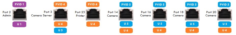

VLan not VLanning on GS728TP
Have several cameras which I'd like to put on their own vlan. And I have a server that handles those camers, which I'd like on the camera vlan and default vlan. I find that the GS728TP has 3 default v...
- Oct 19, 2017
Here is how it should be configured as shown in the image below provided that all devices are within the same subnet:About port 3 where the camera server is connected on VLAN 4, it should be set as untagged (U) with PVID 4. It should also be set as untagged (U) on VLAN 5 to have communication to the cameras connected to ports 14, 16, 18 and 20.
For ports 14, 16, 18 and 20, it should be set as untagged (U) with PVID = 5. These ports should also be set as untagged (U) on VLAN 4 in order for the camera server to have access to the cameras.
About port 23, I did not know that it is the LAN printer. Port 23 should be on VLAN 4, untagged (U) and PVID = 4.
About port 2, you may set it as a member of VLAN 4 (if ever you want it in VLAN 4) set as untagged (U) with PVID = 4.

I can indeed now ping the cameras from the cameras server.
But this doesn't make sense. I see why the pvids must be this way, but this is adding the cameras to both vlan4 -and- vlan5? This way I am depending exclusively on ingress filtering to separate the vlans? Nowhere does any documentation describe this method.
Is this the trick so that the cameras server (3) can dwell on both 4 & 5 and so the cameras can communicate with it? But the cameras server has ingress filtering set to 4, so how can it receive anything from 5? Why must the cameras be in both vlan 4 & 5 when 5 is their domain?
Port 23 is the LAN printer, so this should only be on vlan4 and pvid4?
And what about admin of the switch? Port 2 is what I admin through, so should it be on vlans4 and 1with vpid1? Or vpid4?
My understanding is that only one Default vlan is allowed for each vlan? So from a security standpoint (such as it is for vlanning), shouldn't only the admin machine have access to the switch Default vlan? What is the purpose of the A/V and Voice Default vlans?

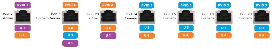

But my question is, I want to make port 2 not just the management port, but I also want port 2 to be a member of vlan4. My prior attempts to do this failed, causing me to have to factory reset the switch.
In other words, I don't grasp the dynamics of input filtering (vpid?) versus vlan membership (vlan?) If I set port 2 to vpid4, I doubt it can manage the switch. I have tried leaving port 2's vpid at 1 and adding it to vlan4 Untagged, but it can not ping any members of vlan4. How can this be? It can still ping and manage the switch, but when Untagged to both vlans1 and 4 it cannot reach anyone on vlan4.
It seems that the sole determinant of vlan membership is vpid.
- DaneAOct 24, 2017NETGEAR Employee Retired
Applying what we know about Asymmetric VLAN, you will need to set the following below in order for port 2 to have connectivity with the devices in VLAN 4:
1. Set port 2 as untagged (U) on VLAN 4 with PVID = 1.
2. Set ports 3 and 23 as untagged (U) ports in VLAN 1 with PVID = 4.
Refer to the image below:
Even though VLAN 1 is the management VLAN by default, some network administrators set the management VLAN to any other VLAN ID because it is already well-known that VLAN 1 is the default management VLAN.
